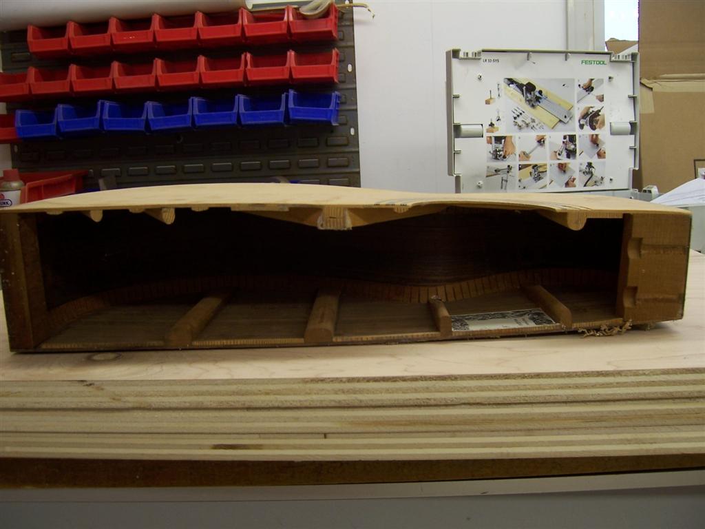

Well there was the time I got the brilliant idea that in order to save time I could run my glued up rim set(with heel block,tail block and linings)in order to flush sand the linings with the sides through my drum sander. I had it in the outside mold with the spreaders in and it worked great-The next time I tried it I forgot to put it in the mold and it exploded!

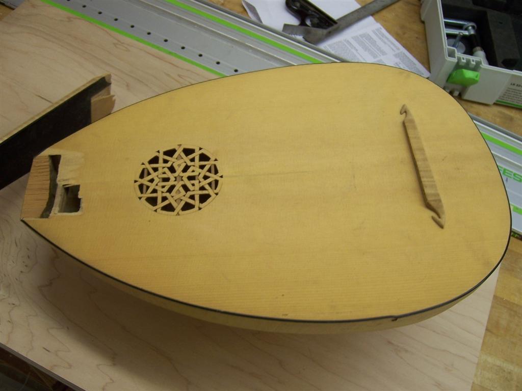

You gotta make at least one lute in order to call youself a luthier:

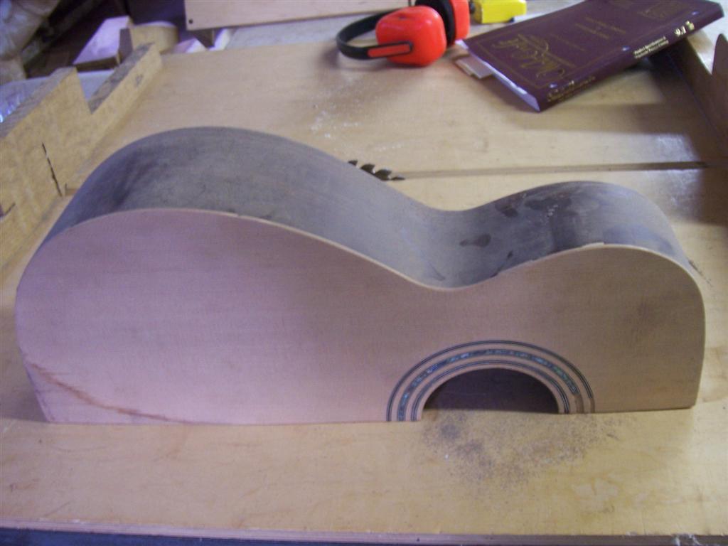

And talk about not being able to see the forest through the trees-I made this big mistake 30 years ago when I was 17 years old-my third guitar.
Hummm, Something just looks a little out of balance but I just can't quite put my finger on it. Maybe it's that bullet hole in the top
